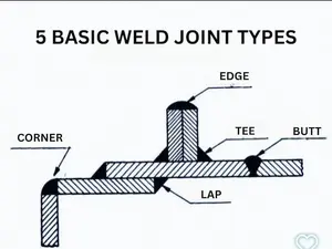

Outside corner joint

  • Fit up is key.  Corner to corner with no gap is what is called for for an outside corner joint in 16ga aluminum.
  • I used a piece of aluminum angle block as backing to remove some heat from the piece…otherwise a small aluminum weldment will saturate with heat and will weld strangely.
  • After making a small tack weld on each end, the piece is ready to weld.
