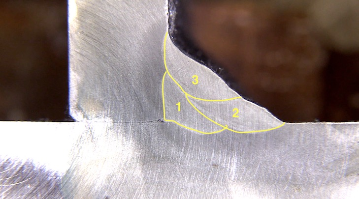

read more about stick welding a multipass fillet
Padding beads in horizontal position with 7018
padding 7018 rod
Multipass tee joint 2f with 7018
3 bead 7018 etched 2F tee
