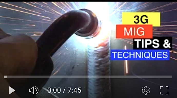

Short Circuit mig 3g plate test
gmaw-s-3g-thumb
A common short circuit mig weld test is a 3/8" thick plate test with 30-37.5 degree bevels where the root pass is welded downhill and the fill and cap are done uphill.
The number of weld passes are usually up to the individual welder.
In this video, I used a total of 3 passes.
root pass downhill, fill pass uphill, and a cover pass.
Watch the video and see the techniques used and then practice.
