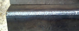

mig-inductance-5
That is why adjusting the inductance makes the arc sound entirely different.  It has a similar effect as setting frequency on a tig welder while tig welding on AC.
A high inductance setting increases the time of each individual arc cycle and therefore can improve wetting of the puddle.
A low inductance increases the frequency of each short circuit/arc cycle and can be useful for pinpointing a narrow bead in some joints.

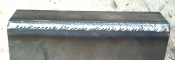

What this means to most folks is high inductance is good for thicker metals where good wetting at the toes of the weld is a priority….and low inductance works better on thin metal.
mig-inductance-95
