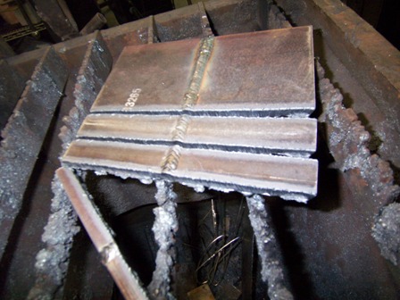

That gave me an idea… Would the Hobart Trek 180 would be able to weld a 3/8” thick multi pass v groove weld similar to a structural welding certification test running strictly off the battery?
The Hobart Trek 180 uses small 2 lb spools and all I had was .024” E70s6.
But what the heck. I gave it a go.
3g weld test with hobart trek 180 battery powered mig welder
The plates I welded were 3/8” thick with a 22.5 deg bevel. I gapped the plates about 1/8” and welded a root pass downhill with the Trek 180 set to 10 on voltage and 100 on the wire feed. (those were the recommended settings for 1/8” metal on the settings chart on the wire feed cover.)
The root pass went in pretty well. No big surprise. Open butt roots downhill don’t take much amperage. But this was only a 45 deg included angle..that’s kinda tight.
Second pass looked like it was going in fairly well but I was wishing for a little more punch. (I was still only running off the battery.)
Third pass was going fine, partly due to the good preheat from the first 2 passes…then half way through the last pass, the battery light came on and it quit welding.
Not too bad since I had already welded about 40 inches of weld on 18 and 14 ga steel.
The two and a half passes on the 3/8” thick v groove weld actually equated to a lot more inches of weld since a root pass is kind of slow and the other passes were weave passes.
I plugged the machine in to charge and in just a few minutes, it was ready to weld again so I finished the last half of the cover pass on the 3/” v groove weld test.
Man what a difference when I plugged it in. The last half of the cover pass went in nice …plenty of heat.
But would it bend? Only one way to find out
2 bend straps were cut from the last half of the weld and bent in a standard weld test bender made to American Welding Society AWS B4 specs…one root bend, one face bend.
welding bend test hobart trek 180
hobart trek 180 review bend test
Here is what happened.
Root and face were clean. But there was a little bit of sidewall lack of fusion between the root pass and second pass. Not enough to make it open up on the bend test but still worth noting.
This test would have passed in most test shops. It passed AWS criteria which allows up to 1/8” open defect on the root or face surface.
Pretty amazing since I was way out of scope with the .024” bare wire on 3/8” plate.

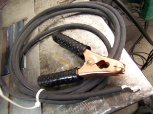

The Ground clamp!.
If you buy this machine, do yourself a favor and get Millers new ground clamp with dimpled copper jaws and shunt strap. Mig welders need good ground clamps!! Are you listening Hobart??
