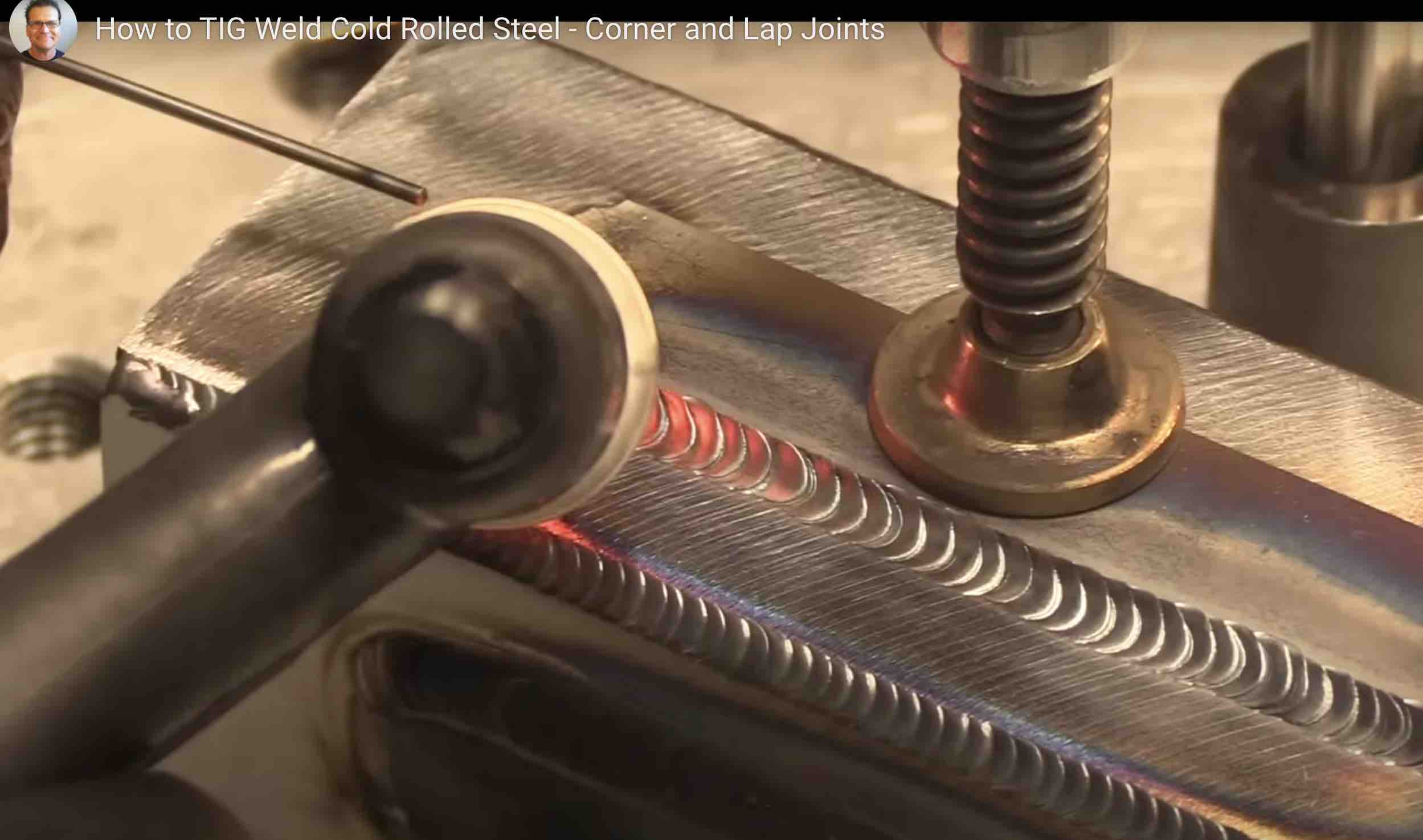

In this quick video Welderskills.com instructor Andrew Cardin demonstrates on how to tig weld a carbon steel lap joint on 11ga cold rolled steel.
Cold rolled steel 11ga (.125" thickness)
DCEN 122 AMPS
Jazzy 10 ceramic cup
30 cfh argon flow rate
post flow set to 10 seconds
3/32" 2% lanth electrode
1/16" ER70S6 Filler wire
Welding a carbon steel lap joint boils down to a few key factors.
  • amperage setting
  • filler wire size and type
  • arc length
  • torch angle
  • shielding that hot tip of the filler rod
An amperage setting of one amp per thousandths of thickness will get you in the ball park.
Filler wire size is mostly personal preference but for 11ga cold rolled steel a 1/16" diameter ER70S6 filler wire works pretty good.
arc length should be equal to or less than electrode diameter
torch angle is pretty forgiving provided arc length is tight ..try to limit torch angle to around 20 degrees.
the hot tip of filler wire gets oxidized if not shielded by argon.  try to keep the hot tip of filler wire in the argon envelope.
