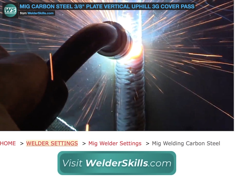

This Video shows Tips and Techniques for passing a 3g GMAW-S plate test.

Root pass settings and techniques
Settings for the Root pass were 17 volts and 180 inches per minute on wire speed.
I tilted the mig gun back quite a bit so that I could aim the tip of the wire right at the front edge of the puddle...and I tride to keep the arc right on the front while wiggling the gun slightly from side to side.
In gmaw welding there is something called CTWD.
It stands for "contact tip to work distance"
Another term that is very similar to CTWD is "stickout"
The length of stickout affects amperage.
Too long a stickout on the root and amperage drops and you can also lose shielding.
But too short a stickout can cause a blowout if your settings are off a bit.
I tried to keep my stickout consistent throughout the root pass so that the root penetration would be consistent.
Fill pass settings
I chose to weld this test plate in 3 total passes.
Root, Fill, and Cover pass.
Settings for the Fill pass were 18 volts and 210 wire speed.
After the Root was welded, I wire brushed and immediately welded the fill pass without cooling.
I tried to stop short of filling the groove by 1/16" (1.6mm) on each plate edge.
I used a technique that sort of resembles a rainbow as I moved the arc from side to side pausing for a moment on the toes.
Cover pass settings
I let the piece cool down do around 150f before the cover pass.
I used 17.7 volts and 200 ipm for the cover pass and tried to overlap edges by only 1/16" (1.6mm)
