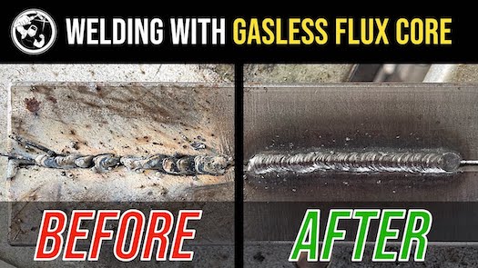

Hey if you missed the first video on setting up the machine and the #1 BIG mistake most people make on flux core, here it is
flux core before after thumb
In an earlier video, I set up a mig machine from scratch and showed how important it is to make sure the right polarity is used.
