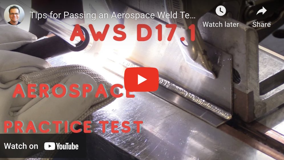

The first video above shows tips for passing a AWS D17.1 stainless tee joint fillet weld test
A tee joint is normally considered to be an easier weld test than a butt joint.
But for an aerospace weld test on .063” and thinner, the tolerances for lack of fusion as well as melt thru are so stringent that tee joints can be more difficult than butt joints.
When you get down to thinner metals like around .040” and thinner, there is a pretty tight window of amperage, travel speed, and filler metal dabbing that will get fusion into the root with no melt thru.
The cup you use can make a tremendous difference in the way the puddle flows at low amperage.  An oxide free puddle flows better than a dirty oxidized puddle.
A cup that completely shields the puddle along with the hot tip of the filler rod makes a big difference on alloys like 15-7ph and 17-7ph stainless.
And as you can plainly see in the video above, also works great in preventing any discoloration on any stainless steel alloy.

Tips for passing a Titanium Tee Joint Aerospace test per D17.1
titanium-tee-d17-thumb
If you watch both of the videos on this page, you will notice the technique is very similar for both stainless and titanium.
Except for titanium, the movement back and forth is just a bit more pronounced in order to flow the metal into the root of the joint without melting thru the back side.
