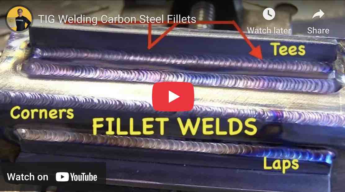

Carbon Steel TIG welding

Tips for carbon steel tig welding
  • Aim for a tight arc length. (equal or less than tungsten electrode diameter)
  • limit torch angle but torch angle can be very forgiving provided the arc length is tight enough
  • keep the hot tip of the tig rod shielded with the argon coming out of the cup
  • a gas lens cup upgrade like a Jazzy 10 ceramic can help a ton in not only better shielding but longer stickout

One of the keys to carbon steel tig welding is metal prep.
It is difficult to make a decent weld when there is a thick layer of mill scale.
Clean bright metal is what you want...mill scale completely removed and not just polished.
