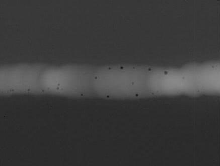

Cleaning the edge before welding is key to passing any titanium welding test.
A 2G test is more likely to show porosity on X ray than other positions so clean those edges thoroughly before welding.
The main cause for failure on a titanium weld test is porosity and porosity is mostly caused by some type of contamination like oil or embedded grit from a sanding disc.
the x ray negative below shows scattered porosity in a titanium weld.
welding titanium xray
