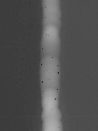

The 3 c’s also come into play: Clean, Clean, and Clean. Titanium has to be very clean and free from oil, grease, coatings, and oxides before welding takes place. Oil or grease will cause porosity like you see in this x-ray negative of a titanium weld. But porosity is the least of your problems.
