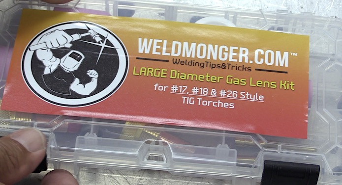

This page is about tig welding aluminum with a gas lens kit and #6 cup.
I don't always use a gas lens on aluminum.
 In fact there are many situations where a standard #5 cup and collet body work just fine.  Sometimes even better than a gas lens,
But for the particular weld in this video, I was using an air cooled 17 style torch.
Its a good all around torch for me and can handle 200 amps for brief weld but,  it can get pretty hot at 175-200 amps if you weld very long at all.
So I decided to use a gas lens setup because the extra mass you get with a large diameter gas lens collet body helps keep the torch cooler...at least a little bit.
A 17 style air cooled torch is typically rated at 150 amps but  I often go higher than that for short periods without a problem.
If I were to get an order for 100 of these parts, I would definitely go with a water cooled torch.
