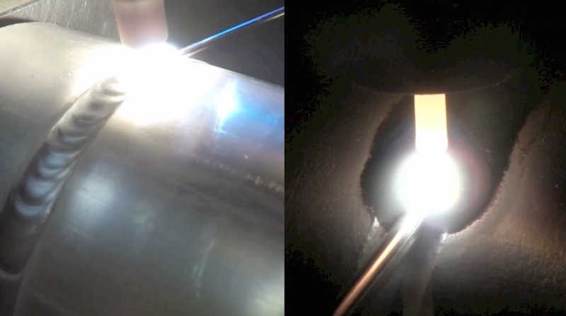

A lot of welders like to use a standard #5 cup for tig welding aluminum But For filming this weld, I used a gas lens so that I could extend my electrode a bit, still get good gas coverage, and be able to film the arc and puddle better.
I typically extend the electrode just far enough for me to see the tip without straining or tilting my head...which winds up being somewhere around 1/4" -3/8".
I like to hold a fairly tight arc length and if I cant see the tip , I cant tell how tight my arc is.
...But some welders actually dont extend the electrode at all.
You can make it work either way, but I find I have more versatility getting it tight corners , or down in holes, if I extend the electrode.

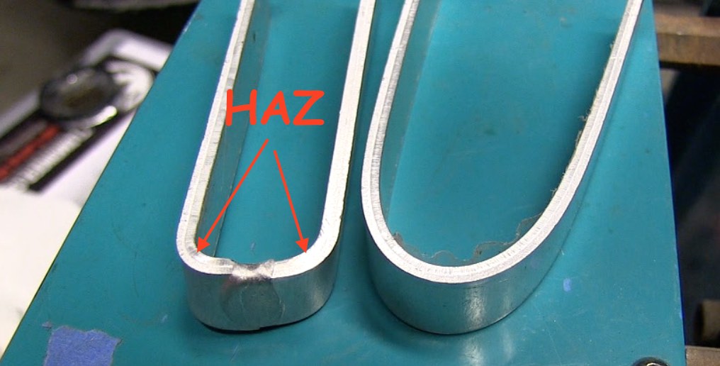

Heat Affected Zone
One thing every welder needs to know is that heat from welding affects metal.
Heat affects different metals in different ways but there is always something called a "heat affected zone".
According to Wikipedia, The heat-affected zone (HAZ) is the area of base material, either a metal or a thermoplastic, which is not melted and has had its microstructure and properties altered by welding or heat intensive cutting operations.
Since fusion welding melts the base metal, there is always a HAZ.
the goal is for the HAZ to be acceptable when it comes to material properties needed for the serviceability of the product.
