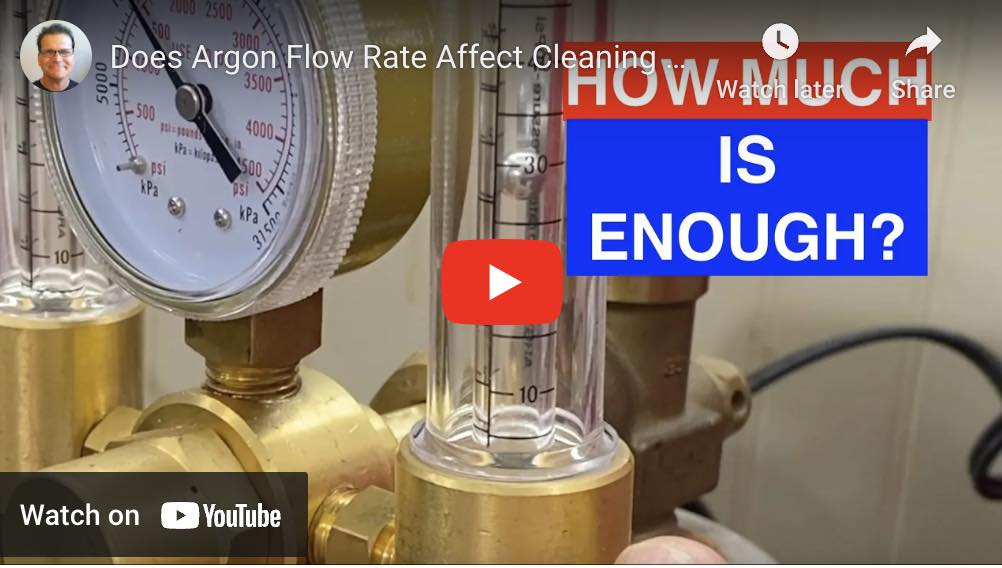

What is the best cup to use for aluminum?
I think a #6 gas lens is a great all around cup for TIG welding aluminum.
A #6 gas lens allows you to extend the tungsten more than a standard collet body cup but also confines the cleaning action etch zone just a bit.
15 to 20 cfh of argon flow is usually adequate but that depends on your flowmeter as well as the type of joint you are welding as well as some other factors.
argon-flow-rate-thumb
Argon Flow rates for each Cup size using 2.5 as factor
tig cup size chart
