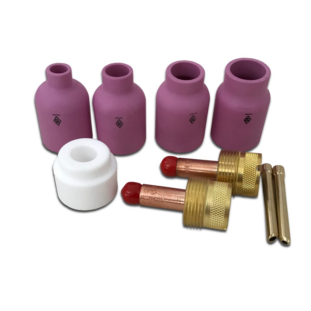

ally 5 combo kit contents
This #5 combo kit  includes a clear #5 as well as a ceramic #5 cup along with collet body and all the parts needed to fit your torch. We have a kit for #9-20 style torches as well as 17, 18, 26 style .
ally 5 combo kit label side
Is it a #6 gas lens?
...or a #5 cup with standard collet body?
Does it even matter?
It definitely matters.
But it depends what you are welding.

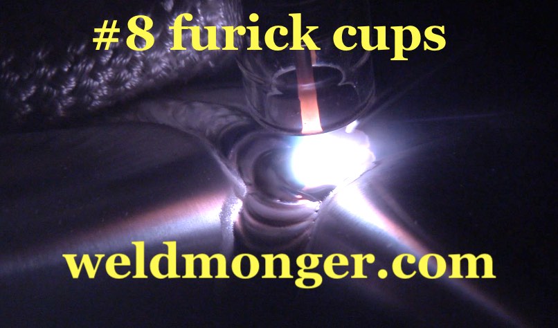

Furick #8 pro clear cup
Another cup I like to use for applications under 200 amps is the Furick #8 pro clear cup (and now there is a #7 that I like even better for aluminum.)
Not only is it a great all around cup for all metals, but its clear so there are times when I look right thru it to weld in corners.
It also helps me see better.  I am in my 60s now and this cup really helps light the path and also really helps with me filming.
It works with 9 and 20 style torches simply by slipping an o ring over the gas lens.
For 17, 18, and 26 style torches, an adapter kit is needed.

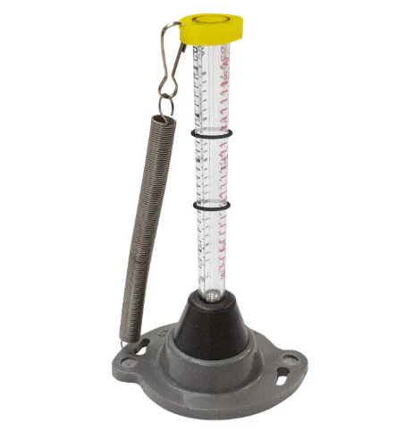

One of the main benefits to using a #5 cup is argon savings.
a setting of only 12-15 cfh works in most situations but since flowmeters are not all calibrated accurately, it pays to test out the argon flow setting with a gas flow tester or by actually puddling on scrap aluminum to verify the etch zone.
For me, the #5 cups work good for 1/8" and thinner aluminum.
