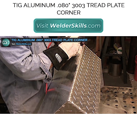

TIG ALUMINUM .080" 3003 TREAD PLATE CORNER
scroll down for settings used
challenger kit 17 front
challenger kit 17 contents
METAL TYPE = ALUMINUM 6061
THICKNESS =  .080"
WELD TYPE = FILLET WELD
JOINT TYPE = OUTSIDE CORNER JOINT
POSITION = 1F
AMPERAGE = 100  CONTROLLED WITH FOOT PEDAL
FILLER WIRE = 3/32” 4943
POLARITY = AC
GAS FLOW = 15-18 CFH argon
CUP SIZE =  8
ADDITIONAL SETTINGS =   AC BALANCE 33% CLEANING, AC FREQ 100 HZ
PRE FLOW = .5 SEC
POST FLOW = 7 SEC
TIPS: KEEP A FAIRLY TIGHT ARC AND KEEP  TORCH ANGLE TO A MINIMUM
Aim for an arc length that is equal or less than the diameter of your tungsten electrode.Torch angle can be forgiving provided your arc length is tight.
