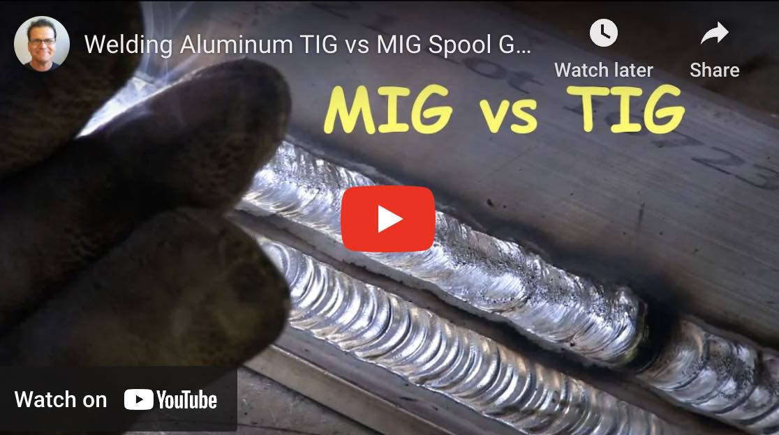

TIG welding is usually slower than MIG but more precise and thinner aluminum can be welded with TIG.
Rule of thumb on this is 1/8" (3.2mm) and thicker aluminum can be welded with MIG. There are exceptions to this rule but its a good starting point.

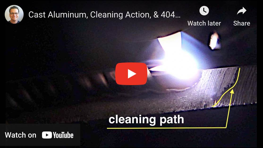

What is this thing called "Cleaning Action"?
cast-aluminum-cleaning-action-thumb

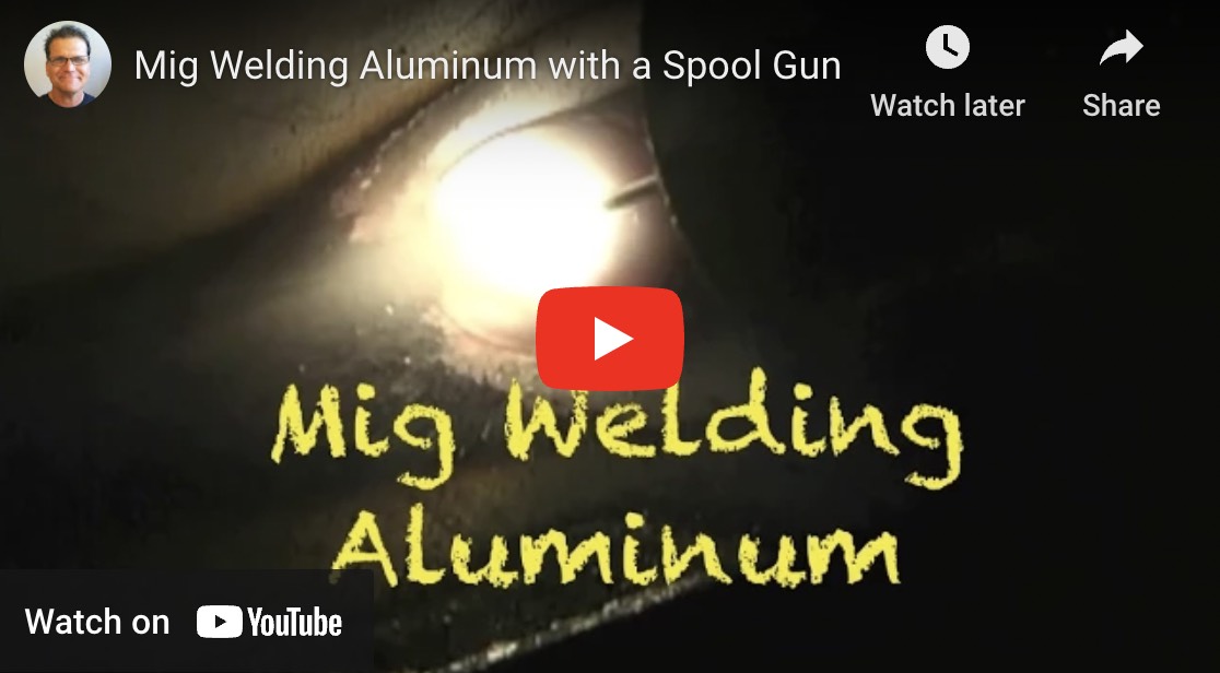

HOW TO WELD ALUMINUM USING MIG with A SPOOL GUN
mig-aluminum-spool-gun-thumb
MIG welding is usually much faster than TIG but less precise and requires a spool gun or special setup like a Teflon liner because aluminum wire is so much softer than steel wire, it is difficult to fee thru a liner.
Even though TIG is more precise and can weld thinner aluminum, MIG is often the best choice for speed as well as portability.
mig-vs-tig-aluminum-thumb
Spool gun setups are more affordable than ever and can even be used on a small, portable, and  affordable machine like the Lincoln 210mp. ( which also runs well off a generator)
The Lincoln spool gun that goes with the 210mp is def not the best spool gun I have ever used but it can usually get the job done.
