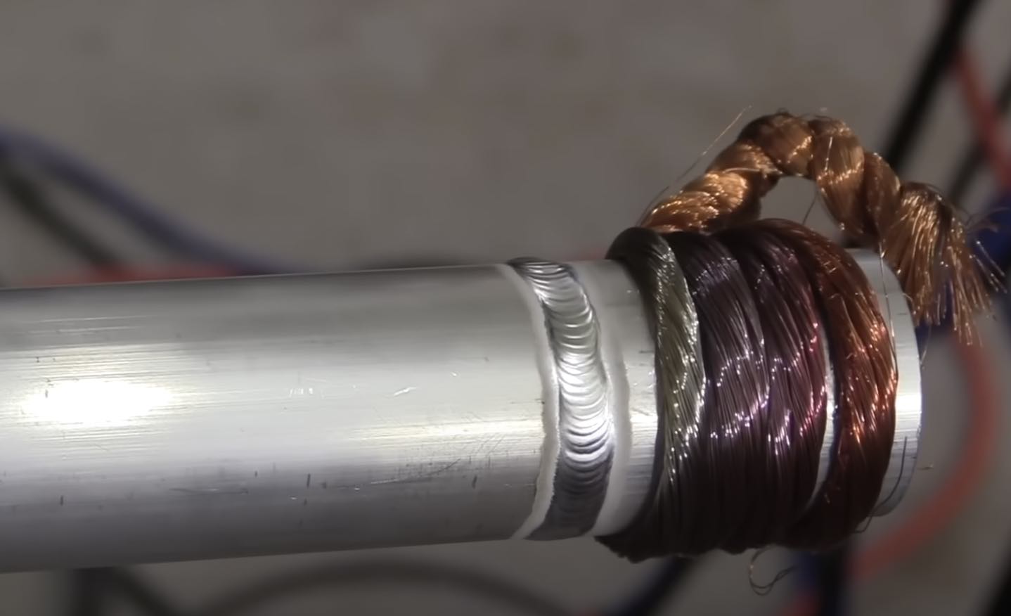

I used pulse settings in the video above but pulse is not always needed for good results.
  • 2 pulses per second, base current 45%, pulse duty 50%
  • AC frequency set to 222hz
  • AC balance set to 32% cleaning
  • 3/32" 2% lanthanated tungsten
  • #7 clear furick cup with 20-25 cfh argon flow rate
how-to-weld-aluminum-tubing
The main tip that made the most difference was the copper braided wire wrapped next to the weld for a heat sink to prevent heat saturation.

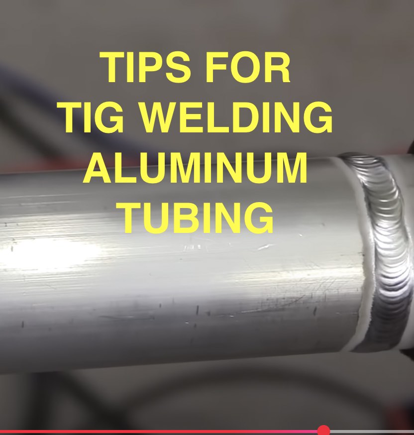

Here are some best practices and tips for how to weld aluminum tubing
  • make sure to clean the metal and remove any burrs from cutting
  • for brand new aluminum that has not been exposed to the elements, this might only require a wipe with acetone.
  • if wire brushing is required, use only stainless steel wire brushes that have only been used on aluminum
  • aluminum is tig welded using AC current and there are two main settings to adjust on newer inverters....AC balance, and AC frequency.
  • Higher AC frequencies can help focus the arc.
  • A full penetration butt joint on aluminum tubing requires approximately 1 amp per one thousandths of thickness in order to get full smooth penetration.  Travel speed makes a big difference and for faster travel speeds, more amperage might be needed.
  • There is a lot of discussion on the best tig cups for aluminum tubing... A lot of welders like to use a #5 standard collet body but there are also plenty of good tig welders who prefer a #6 gas lens.  This really depends on the application, joint type, and personal preference.
  • The edges of any butt joint should be filed smooth to remove any oxides or contaminants.
