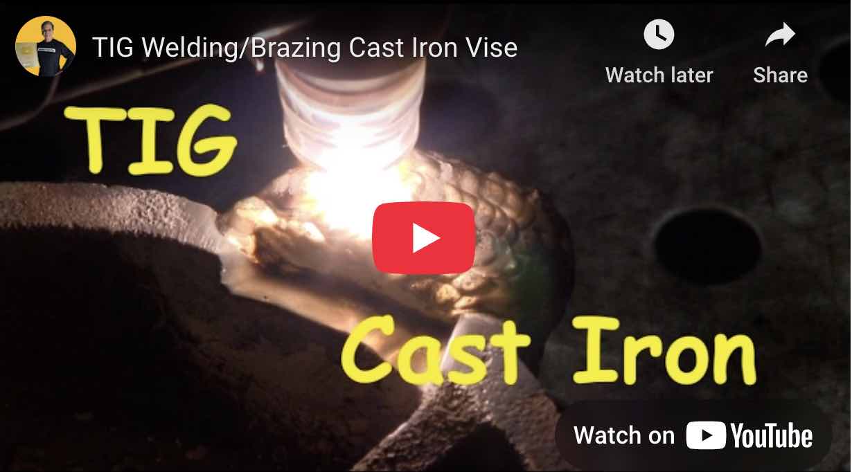

There are several ways to tig weld cast iron but I have had really good results tig brazing cast iron using AC and Aluminum bronze filler rod.  ( thats ErCu-Al-A2)
Technically, this is TIG brazing not TIG welding but results are the main thing.
This video shows a simple repair on a cast iron vise.
Sometimes when a lug is broken on a part ...whether its a cast aluminum transmission housing ...or a cast iron vise...
its easier to build up weld metal than to re attach the broken lug.
In this repair, the lug also had several cracks so I think it was smart to just replace the whole mounting ear with weld metal.

With AC,  very little mixing of the cast iron occurs in the weld bead.  It is truly a tig brazing operation where braze alloy only bonds to the surface of the base metal...but does not penetrate much at all.
and that can be a really good thing with all the carbon and impurities that are in cast irons.

Preheat really helps slow the cooling rate and that usually helps as much or more than any other one thing for cast iron repairs.
But I only preheated to around 300f for this repair.
and since I was using a small hand held mapp gas torch, I had to camp out for about 5 full minutes in order to get the vise base hot enough
Typically, for welding I would prefer a preheat of 500-600f.
But for this type of tig braze repair where multiple beads are used, there can be a beneficial tempering effect on every layer that helps to temper any hard and brittle area created by the first layer of beads.
