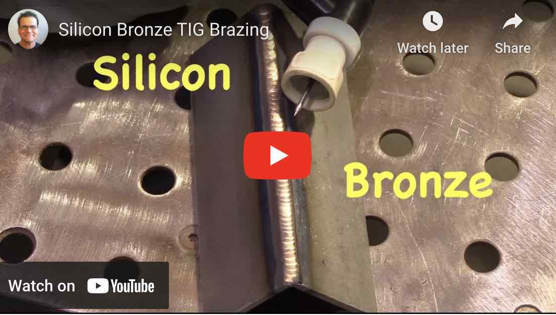

TIG brazing on a carbon steel Star project
tig-brazing-silicon-bronze-star-thumb
TIG brazing and how to TIG braze carbon steel
silicon-brronze-tig-rod-outside-corner-thumb

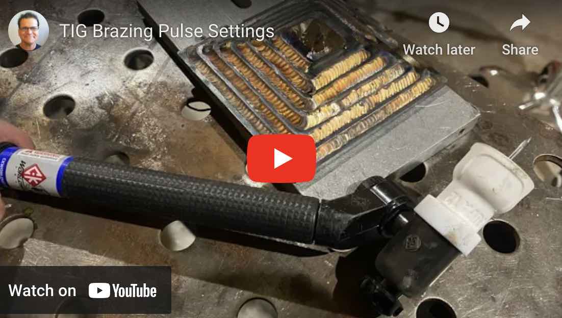

how to tig braze a carbon steel lap joint with pulse settings
tig-brazing-laps-silicon-bronze-thumb

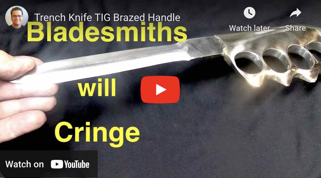

TIG brazing a handle on a File to make a trench knife
tig-brazing-trench-knife-silicon-bronze-handle-thumb

For clean metal, I like to use silicon bronze on DC, a large gas lens cup like a Jazzy 10 ceramic, and 33 pps.
pulsing at 33-50 pps seems to help agitate the puddle and keep it moving at low heat input

You always want to use a technique that only flows the filler rod and does not actually melt the base metal.
I find that using the rule of 33 (33 pps, 33% on time, 33% background) provides a little bit of puddle agitation and helps keep the heat down too.

Tig brazing with Silicon bronze requires so much less heat than a weld does that distortion is usually quite a bit less.
So that makes it a good choice for a temporary fixture that needs to stay true or flat but does not require a lot of strength.
Sometimes, you need to make a prototype fixture just to see if the idea works.  Silicon bronze is a quick way to do it and is easy to grind loose too.
