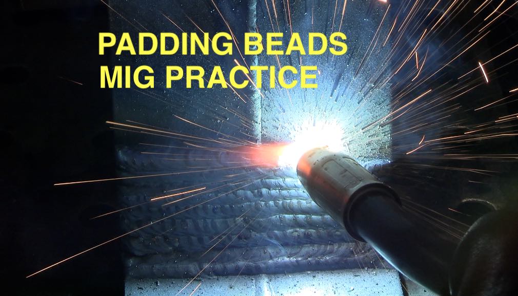

Practice and experiment: Welding beads on plate is a great way to get the kind of practice and hood time you need to get better.
The practice Metal does not have to be expensive or very thick to get good practice. in fact, I have found that 11ga steel is plenty thick enough to use for mig welding practice.
You can grab some small pieces of 11ga steel off amazon or from jflf.org and set them up in kind of a vertical position but leaned back at an angle like this....
padding beads mig practice
this puts the piece at a good angle where you can be comfortable and also have a good line of sight..and lets you weld bead after bead without burning thru a lot of metal.
Weld both directions, try pushing and pulling angles, Experiment with different settings, wire speeds, wire sizes, and techniques to find what works best for your specific application.
The mig settings chart that is on the inside of the wire feeder door on most welders is only a starting point. I have found that the wire speed is often a bit too much for some applications so while you are experimenting with settings, try using the recommended settings but then reduce the wire speed by about 10-15% and weld some beads.
