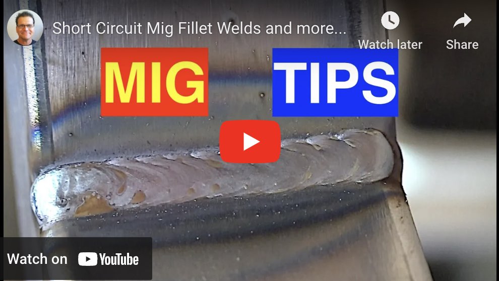

Basic MIG Welding Tips and Techniques
mig-tips-fillet-welds-thumb
