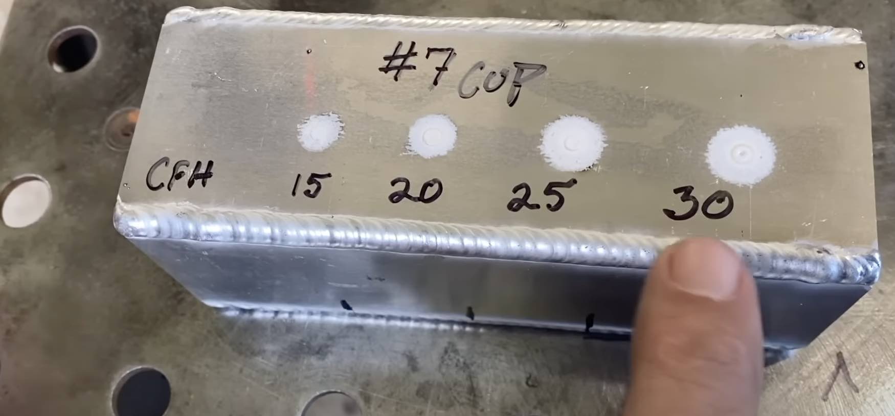

What affect does argon flow rate have on aluminum cleaning action for tig welding?
Argon flow rate, cup size, and AC balance are all related.
This video explains how flow rate affects cleaning action on aluminum.

I think we can all agree that argon shielding gas plays a critical role in the cleanliness and quality of aluminum TIG (Tungsten Inert Gas) welding.
But how does cup size, argon flow rates, and ac balance affect the cleaning action of the AC arc?
The reverse polarity or electrode positive part of the AC current is where we get a phenomenon called "cleaning action" where electrons and ions act as a sandblasting action to break up aluminum oxides on the surface of aluminum.
AC balance is the setting that controls how much cleaning action you get.
But argon flow rate also has an affect on cleaning action because....
The cleaning action only wants to go where there is adequate argon shielding.
We tested different flow rates using the same size cups to determine how flow rate affected the size of the cleaning path.
