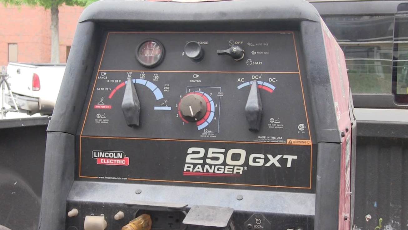

Power Mig 210mp and Lincoln Ranger engine drive
The Lincoln 210mp runs well off a generator and is pretty simple to set up.
JD uses the Ranger portable welder a lot to power the 210mp for tig root passes in pipe, stick, and for dual shield flux core welding in the field.
This engine drive seems to provide plenty of 230v power for the 210mp as well as auxiliary power for tools.
He also uses the Ranger to power an Active8 wire feeder suitcase welder  for flux core.
