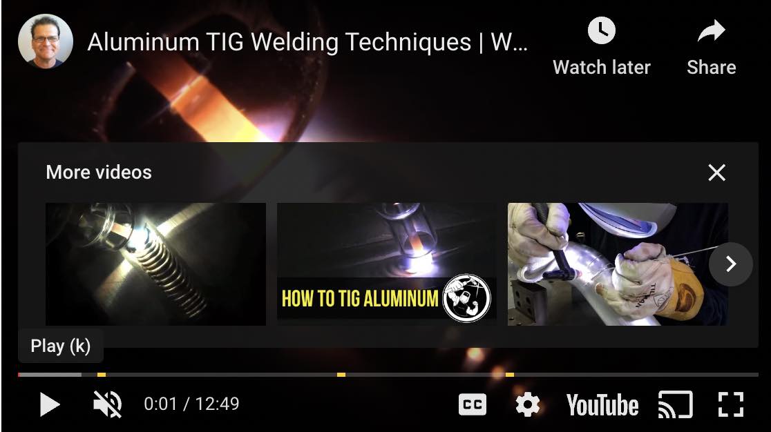

TIG WELDING ALUMINUM .030" 1G BUTT SETTINGS WELDERSKILLS.COM
scroll down for details and settings used
METAL TYPE = ALUMINUM 6061
THICKNESS =  .030"
WELD TYPE = GROOVE WELD
JOINT TYPE = BUTT
POSITION = 1G
AMPERAGE = 30 AMPS CONTROLLED WITH FOOT PEDAL
FILLER WIRE = 1/16” 4043
POLARITY = AC
GAS FLOW = 15 CFH argon
CUP SIZE =  6
ADDITIONAL SETTINGS =   AC BALANCE 33% CLEANING, AC FREQ 150HZ
PRE FLOW = 1 SEC
POST FLOW = 10 SEC
TIPS: KEEP A FAIRLY TIGHT ARC AND WATCH TORCH ANGLE
Aim for an arc length that is equal or less than the diameter of your tungsten electrode.Torch angle can be forgiving provided your arc length is tight.
