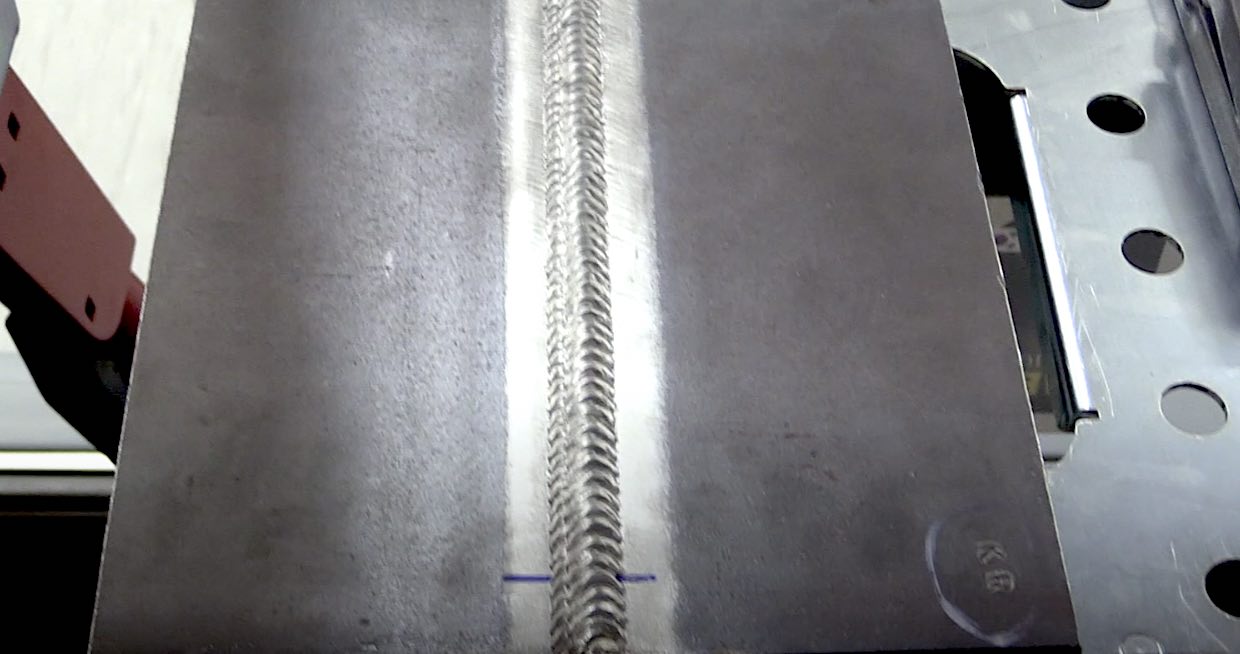

Day 1 ... phase #1 of the competition is common test welds.
2g mig world skills
I would use the term “common test welds” but since the test welds are selected somewhat randomly, occasionally something unusual gets picked like an overhead 7018 open root using Alternating current….thats a really tough one that has been part of the completion in the past.
The selected test joints utilized TIG, MIG, Stick, and Dual shield flux core process in a variety of joints and positions (1G, 2G, 3F, and 6g)
And here is something I found very interesting …
Competitors were allowed to use the welding Machine to its fullest capability …for example, they could use short circuit mig, or pulse spray mig….pulse tig or straight current…etc.
So knowing all the features and settings of a welding machine was a big advantage.
The test joints selected for 2022 world skills welding were as follows:
12 mm 2f tee joint fillet weld using dual shield flux core (total of 3 passes)
12mm 3f tee joint fillet weld using gmaw 2 passes
(Both of these tee joints were tested visually as well as with a fillet weld break test)
10mm 2g open root plate gmaw (mig) all the way
16 mm 1g dual shield flux core with gmaw open root
(Both these test plates were scored with visual inspection as well as X ray test)
6g pipe 4 inch schedule 40 tig root and stick cap
This joint was inspected for acceptable root penetration …visual inspection inside and out and then sent for  x ray test (RT)  at Lincoln electrics new ATF area. ( an ATF is an AWS Accredited Test Facility)

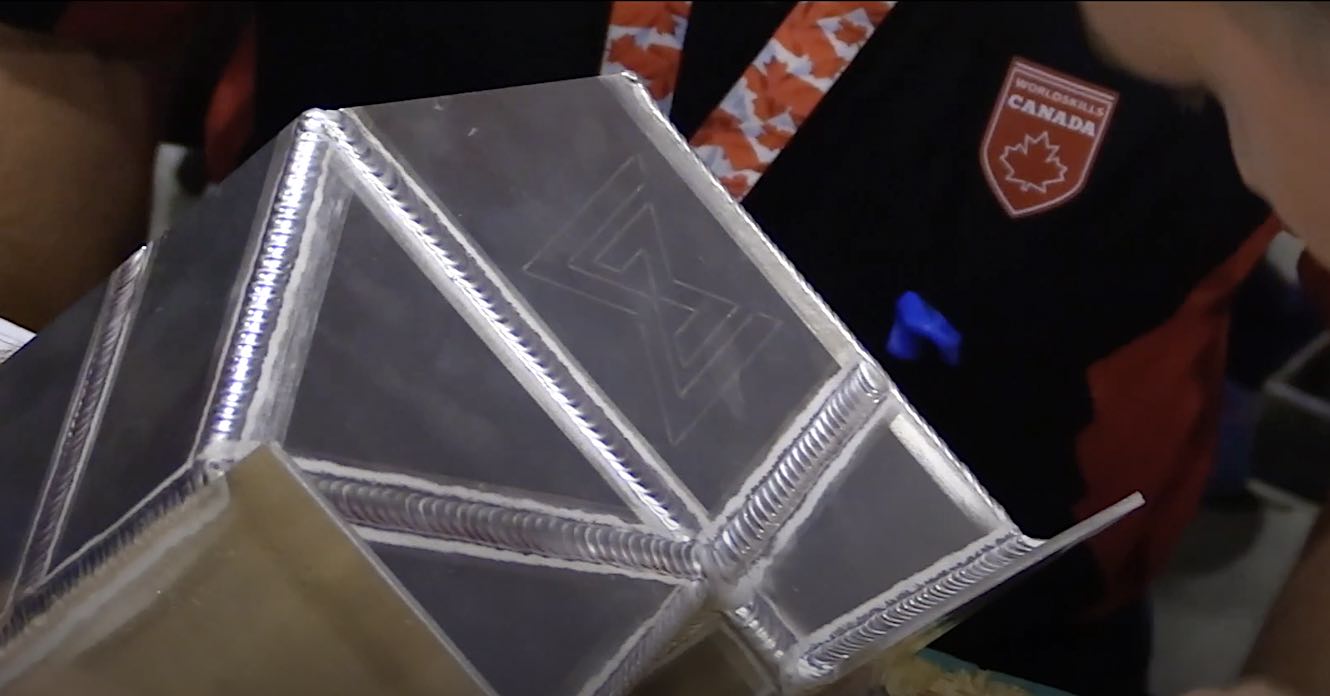

Phase 3....Aluminum and Stainless TIG projects
aluminum tig project world skills 2022
stainless tig project 2022 world skills
The last phase involved both Aluminum and stainless tig projects that also are required to be welded without changing positions of the welds.
The stainless project was last and requires the most time management skills because of the nature of stainless steel in retaining heat and also the gas purging requirements.
A good mix of butt joints, outside corners, and tee joints are designed into both the aluminum and stainless tig projects.
Again the competitors were permitted to use the welding machines to their fullest capabilities so I saw a lot of pulse tig going on on the stainless project.
The scoring on the aluminum and stainless tig process was strictly visual but fillet weld gages were used to verify minimum weld size and calipers were used to measure bead width variation.
The criteria for bead width variation is more stringent than most welding codes.
