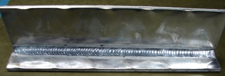

Aluminum is different from other metals in that it has an oxide skin on the surface that has to be broken down before you can effectively weld it. That’s what TIG welding on alternating current does, The reverse half of the alternating current cycle is what breaks up the oxides.

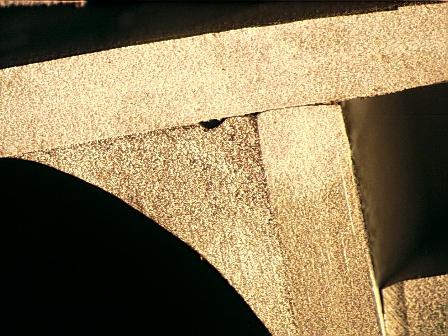

Another important thing to remember about aluminum welding welding metallurgy is that aluminum is hot short. What is hot short? No I am not talking about the shorts Jessica Simpson wore in Dukes of Hazard, the term hot short means that unlike other metals that get more ductile or bendable when they get hot, aluminum actually becomes brittle at certain elevated temperatures. That’s why welding aluminum without filler metal is usually a horrible idea. The stress from shrinkage of the puddle combined with the hot shortness will cause cracking. Especially if you start on the end of the piece being welding. That being said, it is a good idea not to start on an end, but rather weld to an end. Another consideration for Aluminum welding welding metallurgy is something called liquation cracking. It really goes along with the whole hot short thing. What happens is that if you are welding aluminum and almost penetrate thru but not quite. The grain boundaries of the metal are weak under heat and stress and will sometimes open up into cracks. This happens a lot on sheet metal thicknesses when partial penetration fillet welds are called out.
