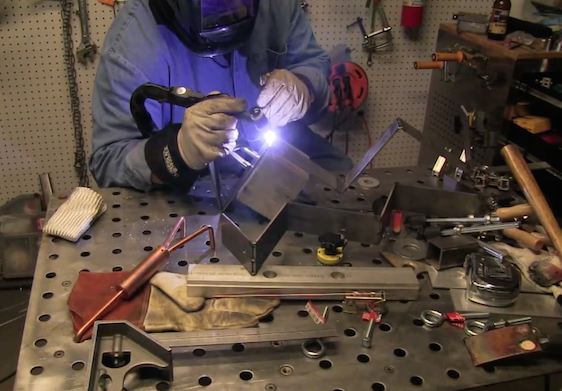

So for this video, I am going to fabricate a rack for 2 gas cylinders....and to do that I used some small magnets to hold the pieces on the table so I could get a few tack welds on them.
each piece is 6 inches long and the 2 pieces on the ends are 4.25" ...and the whole assembly is just a bit over 17 inches.
Since the cart itself is 18 inches wide, that leaves just the enough room for a nice fillet weld on the outside edges of the assembly.
Tig welding the outside corners on the welding cart cylinder bracket...using aluminum backing
For tig welding outside corner joints on carbon steel or stainless steel, you will get a better looking weld with less discoloration and less distortion by using a heavy piece of aluminum for backing.
A heavy chunk of copper works even better but copper scrap is expensive and harder to find than aluminum and aluminum works almost as well.
This trick is especially handy for stainless steel welds.
I save every piece of aluminum I can and keep them on hand to use as backing and for chill bars.  Sometimes I go to a lot of effort to clamp aluminum backing in place but for stainless steel sheet metal, it is worth the effort....the back side of the weld usually comes out almost as if I had used argon backing gas....and the puddle flows better too from less oxidation being pulled in from the back side.
Granted, for these carbon steel pieces, backing was really not needed but I used backing anyway because it only takes a few extra minutes and the welds usually turn out much better.
