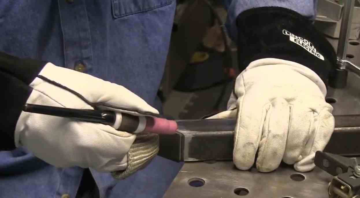

A Torch Switch for tack welding
The cheap imported tig torches you see on ebay usually have the same torch switch zip tied to the torch body.
I am always tempted to cut it off because I usually prefer to use a foot pedal amp control.
But I avoid that temptation because the torch switch is so handy for tack welding around a table....All I do is unplug the foot pedal, plug in the torch switch, and then I am ready to do a bunch of tack welding without dragging a foot pedal around.

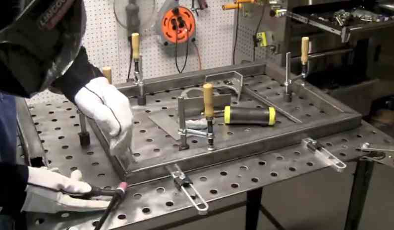

So after getting everything square, on the fixture point table, I put  about 3 tack welds on each corner to hold it together for mig welding.
And then I used a Hobart 210 mvp....  A very good choice for a beginner mig welding machine because its dual voltage.
Today, I set the tap voltage setting on 3 and wire feed speed on about 30 which equates to around 18 volts and 200 ipm of wire speed using .030" er70s6.
That is a pretty cold setting but the square tubing is only about .125" (3mm) thick...at least its supposed to be but it looks a bit thinner.

What is Scratch start tig good for?
So....I figured I havent done any scratch start tig welding videos lately and this was a good chance to do just that.
Scratch start tig is great for pipe welding, and a few other things but in my opinion it only makes sense if you already own a DC stick welder.
If you already own a decent DC stick welder, all you need is a tank of pure argon, a reg/flowmeter, a tig torch with a valve, and not much else and you are in business.
