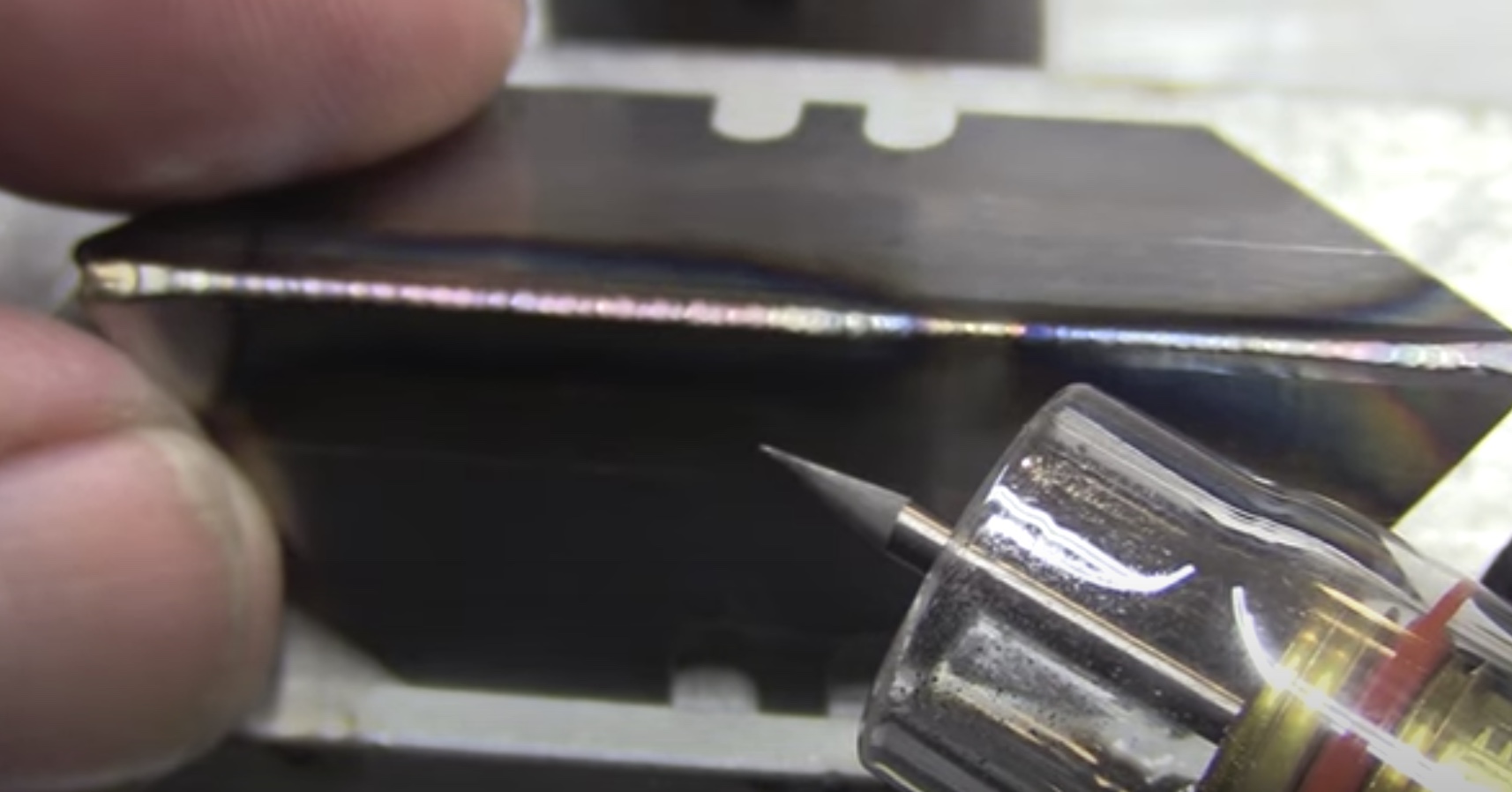

If you use a large diameter tungsten on a very low amperage job, you may or may not get a crisp arc start or a stable arc at low amperage.
(Think 1/8" electrode on razor blades)

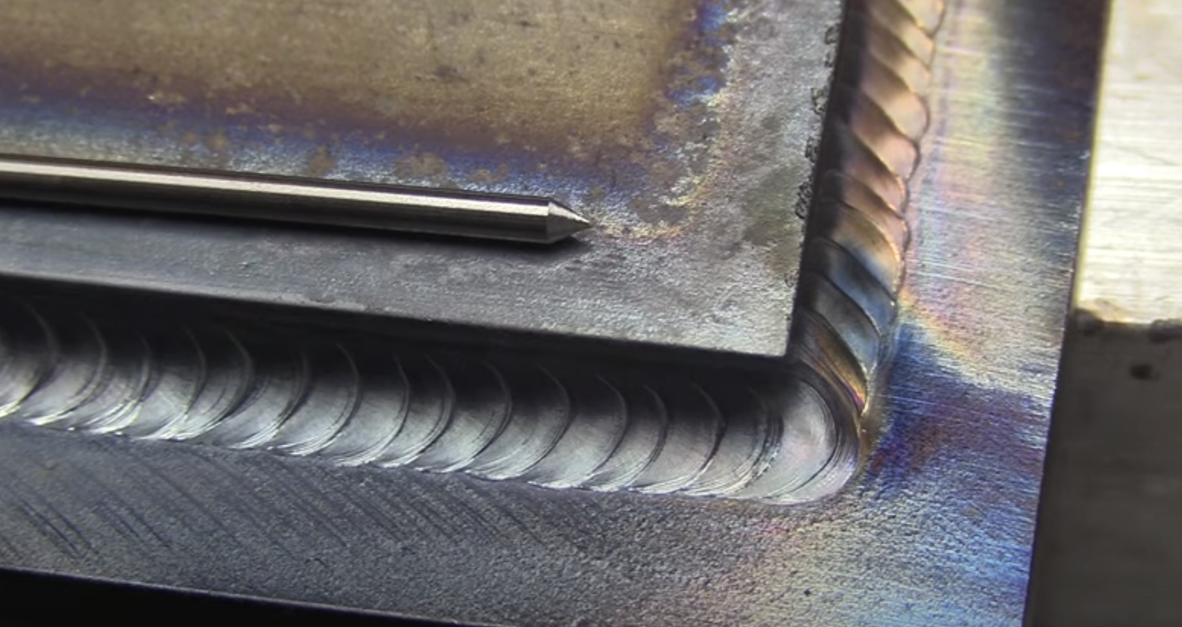

On the other hand if you try to weld thick metal at 200 amps using a small 1/6" tungsten, the tip will melt away and most likely dump into your weld.

So here is a down and dirty chart that is more reasonable on maximum amperage ranges for tungsten on DCEN.
AC maximums are usually about 15%-30% less.
.020”- 20 amps max
.040” - 60 amps max
1/16” - 100 amps max
3/32” - 220 amps max
1/8” - 350 amps max
5/32” - 400 amps max
What about low amp arc starts?

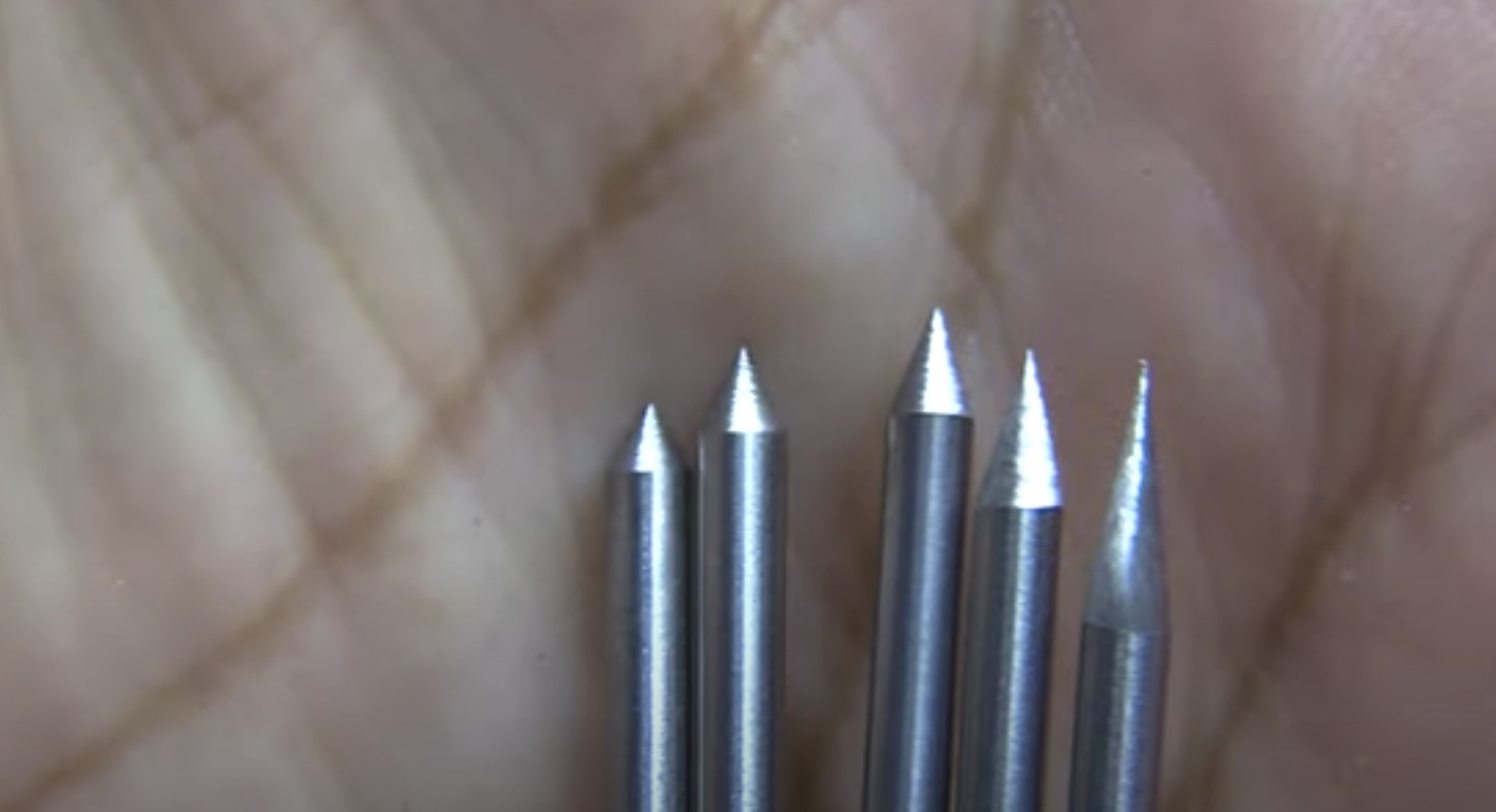

It is true that using the smallest diameter tungsten to get the job done will usually help with crisper arc starts at low amps.
But correctly sharpening your tungsten and having a good ground connection help too.
I keep a 3/32” 2% lanthanated tungsten in my tig torch for 95% of my welding.
I sharpen it like a needle for really thin steel.
I use a more blunt taper for really thick steel and aluminum.

But ...If I need to weld something paper thin, and I am not getting stable arc starts with the 3/32”, I might drop down to a 1/16” tungsten.
