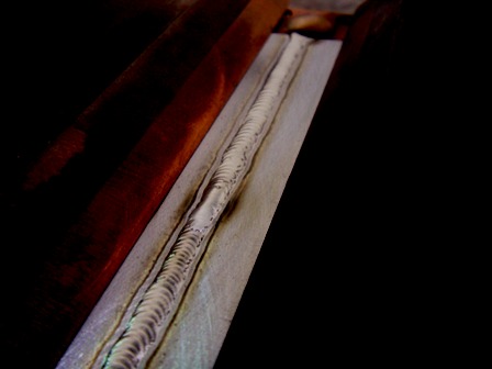

Tig Welding Tip # 12...Taper off Slowly
certain alloys like inconel, hastelloy X, haynes 188 and others will crater crack if you let off the amperage too quickly. 4130 chromoly will do this too. Its a good habit to taper off the amperage while you keep the torch moving.
