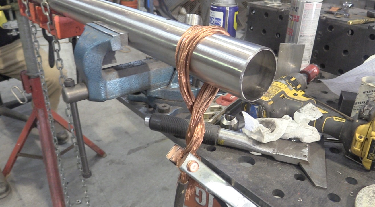

What is that Ground clamp?
Watch more TIG Welding videos
With both ends of this pipe getting caps welded on, and openings all taped up for purging with argon and not wanting get arc marks from the jaws on the pipe vise...
using a piece of bare copper wire from an old ground lead, provided an easy way to rotate the pipe without arc marks.
