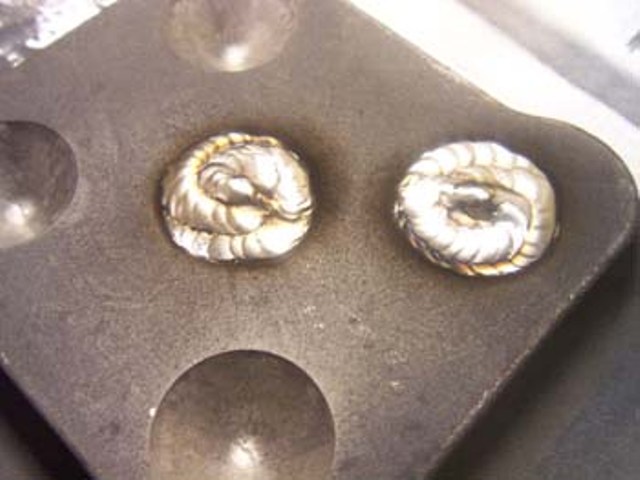

aircraft components like turbine,and compressor blades are repaired using tig welding. the air seals on this blade shown below show weld build up beads that will be restored to original dimensions.
air seal tig welds

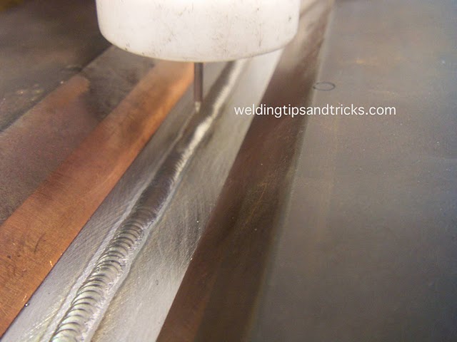

by using chill blocks and an oversize tig welding cup, the discoloration on stainless welds can be limited to a gold color as shown in the tig welding pic below.
gold color tig weld

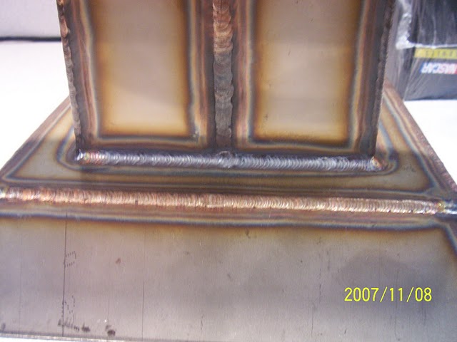

tig welding is used by job shops, and machine shops on all different metals and thicknesses because it is more precise than mig or stick. the weld picture below shows an axle boss welded into square tubing.
steel tig weld
