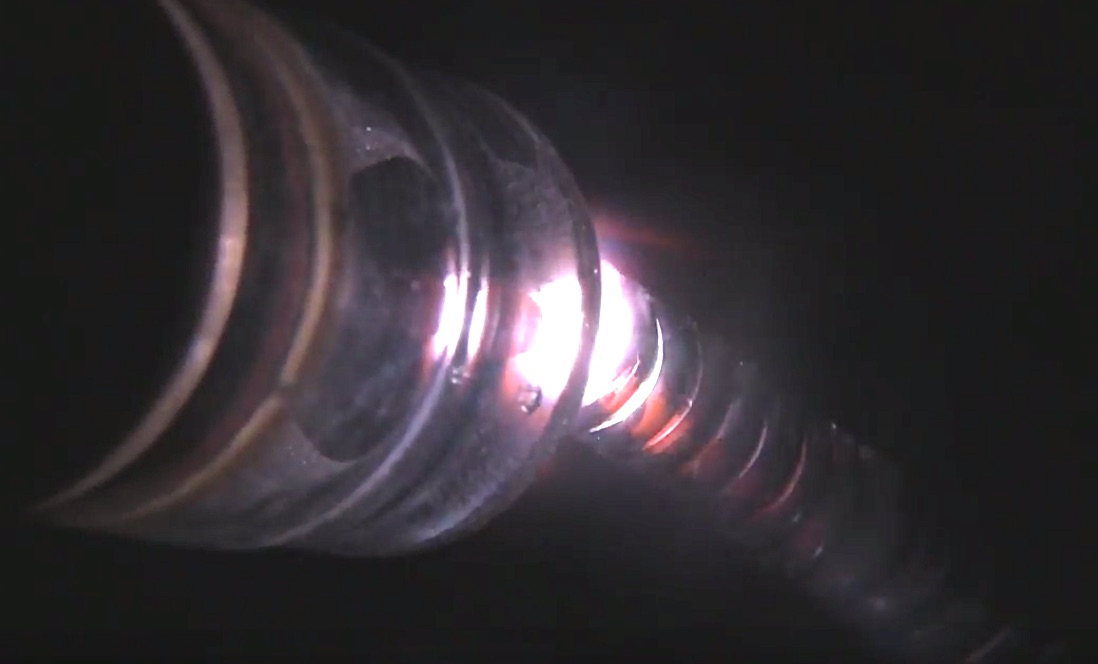

This Video shows tips and techniques for Tig Welding outside corner joints.
Outside corner joints are very commonly used to building boxes, tanks, reservoirs, etc.
Often a press brake or sheet metal brake is used to eliminate as many welds as possible but ultimately an outside corner weld or 2 or 3 are needed to finish the job.
aluminum angle for backing helps remove heat
for these practice welds, I used a piece of aluminum angle.
It not only pulls heat out of the small practices, but it also traps argon gas on the back side.
Although full penetration is not always required on outside corner joints, its good to have some evidence of penetration on the reverse side.
if the weld is done per a drawing, often times a welding symbol will specify depth of penetration.
