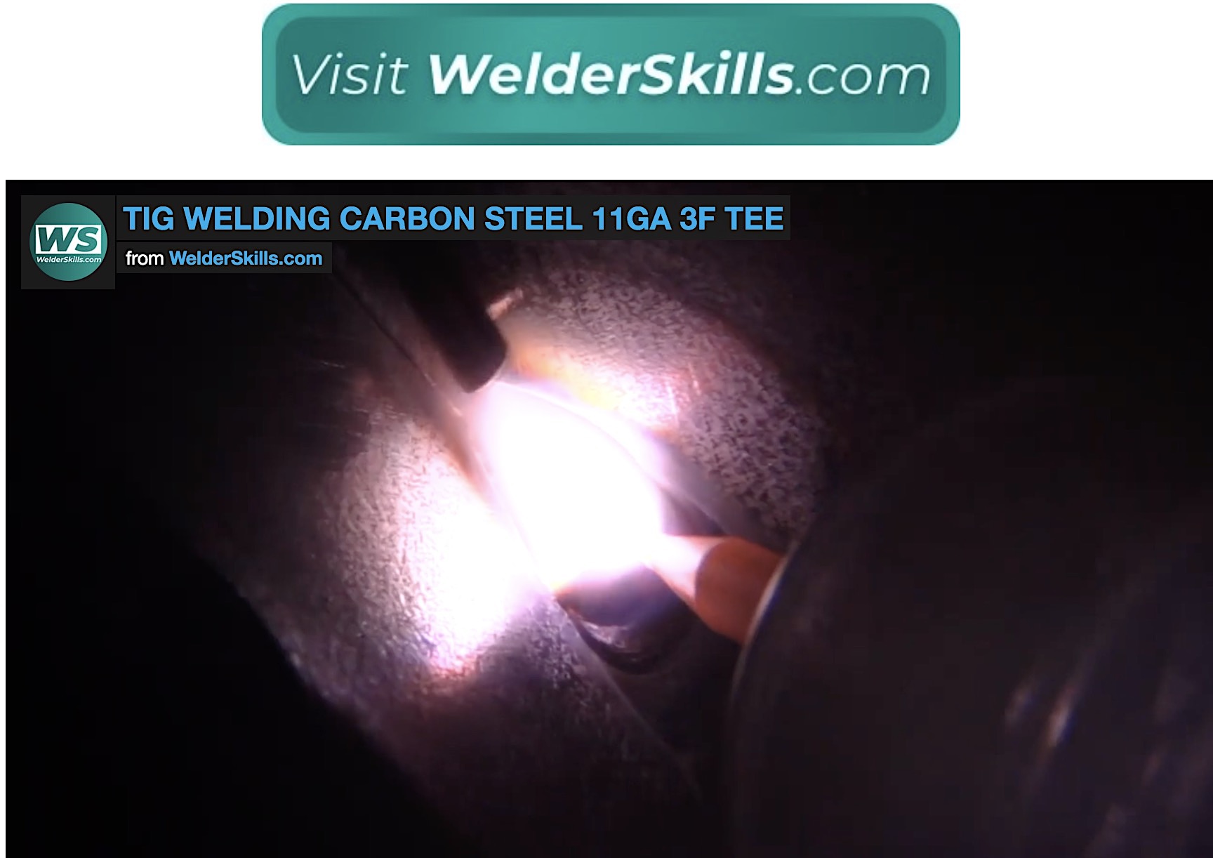

TIG WELDING CARBON STEEL 11GA 3F TEE
scroll down for settings

METAL TYPE = CARBON STEEL
THICKNESS = 11ga
WELD TYPE = fillet weld
JOINT TYPE = TEE JOINT
POSITION = 3f VERTICAL
AMPERAGE = 111 amps with foot pedal
FILLER WIRE = 1/16” ER70S6
POLARITY = DCEN
GAS FLOW = 20 CFH argon
CUP SIZE =  8
PRE FLOW = .5 SEC
POST FLOW = 7 SEC
ADDITIONAL SETTINGS =
 TIPS: KEEP A TIGHT ARC
Aim for an arc length that is equal or less than the diameter of your tungsten electrode.Torch angle can be forgiving provided your arc length is tight.Keep the hot tip of the filler wire shielded by the argon envelope from the tig cup
