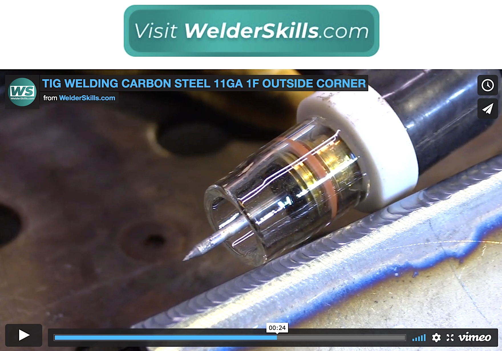

TIG WELDING CARBON STEEL 11GA 1F OUTSIDE CORNER
scroll down for settings
Did you know?...
***you can have a Whole month of access to some of the best TIG welding videos for only one Dollar at welderskills.com
***Its Easy to sign up
No Ads, No BS style
METAL TYPE = CARBON STEEL
THICKNESS = 11GA
WELD TYPE = Fillet weld
JOINT TYPE = CORNER JOINT
POSITION = 1f flat
AMPERAGE = 100-125 amps
FILLER WIRE = 1/16” ER70S2
POLARITY = DCEN
GAS FLOW = 20 CFH argon
CUP SIZE = 8
ADDITIONAL SETTINGS = PRE FLOW = .5 SECPOST FLOW = 7 SEC
TIPS: KEEP A TIGHT ARC
Aim for an arc length that is equal or less than the diameter of your tungsten electrode.
Torch angle can be forgiving provided your arc length is tight.
Keep the hot tip of the filler wire shielded by the argon envelope from the tig cup
