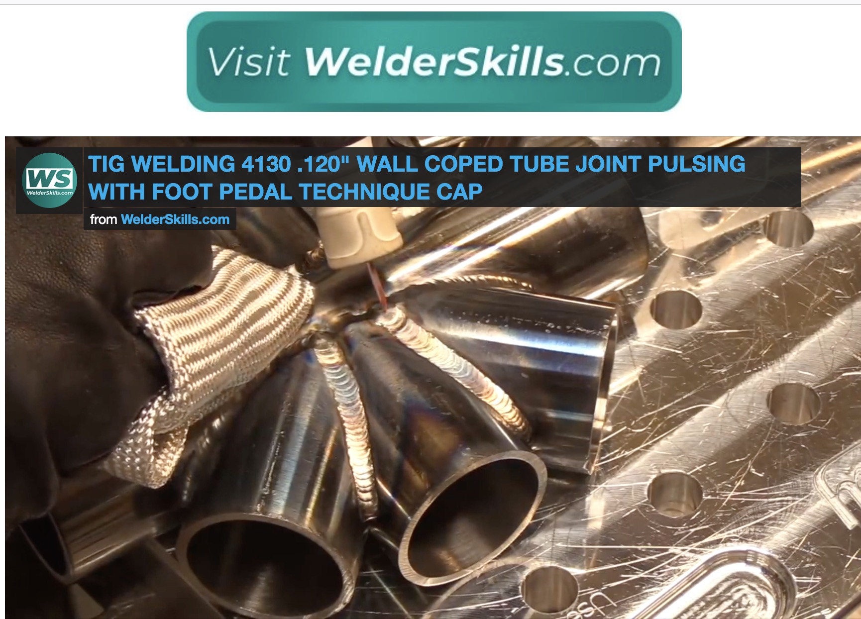

TIG WELDING 4130 .120" WALL COPED TUBE JOINT PULSING WITH FOOT PEDAL TECHNIQUE CAP
scroll down for settings

METAL TYPE = 4130 chromoly tube
THICKNESS = .120"
WELD TYPE = FILLET
JOINT TYPE = COPED TUBE JOINT
POSITION = FLAT
AMPERAGE = 145 amps pulsing with foot pedal
FILLER WIRE = .063” hastelloy W
POLARITY = DCEN
GAS FLOW = 20 CFH argon
CUP SIZE = 10
PRE FLOW = .5 SEC
POST FLOW = 7 SEC
ADDITIONAL SETTINGS =
TIPS: KEEP A TIGHT ARC
Aim for an arc length that is equal or less than the diameter of your tungsten electrode.Torch angle can be forgiving provided your arc length is tight.
Keep the hot tip of the filler wire shielded by the argon envelope from the tig cup.
Snip oxidized tip of filler metal before a restart.
Settings will not always ensure success but I always like to list them because I think it is helpful.
