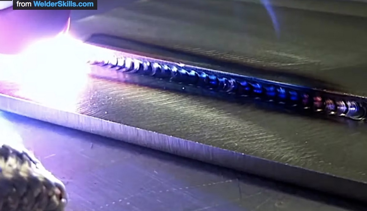

TIG WELDING 11GA COLD ROLLED STEEL LAP JOINT SETTINGS  WELDERSKILLS
METAL TYPE = CARBON STEEL
THICKNESS = 11GA
WELD TYPE = Fillet weld
JOINT TYPE = LAP JOINT
POSITION = 2F HORIZONTAL
AMPERAGE = 95 AMPS WITH .045" ER70S2 , 120 AMPS WITH 1/16” ER70S2 ,
FILLER WIRE = .045" ER70S2 95 AMPS, 1/16” ER70S2 120 AMPS, POLARITY = DCEN
GAS FLOW = 20 CFH argon
CUP SIZE = 8
ADDITIONAL SETTINGS =
PRE FLOW = .5 SEC
POST FLOW = 7 SEC TIPS:
KEEP A TIGHT ARC Aim for an arc length that is equal or less than the diameter of your tungsten electrode. Torch angle can be forgiving provided your arc length is tight. Keep the hot tip of the filler wire shielded by the argon envelope from the tig cup
