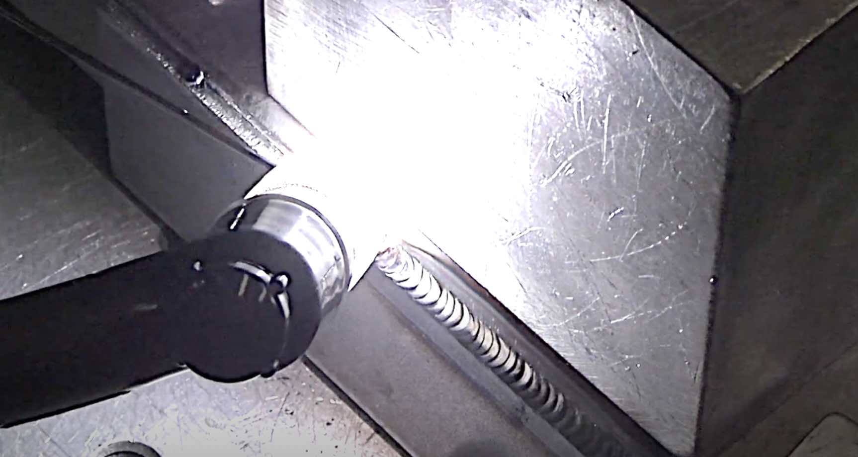

METAL TYPE = CARBON STEEL
THICKNESS = 11GA
WELD TYPE = Fillet weld
JOINT TYPE = CORNER JOINT
POSITION = 1f FLAT
AMPERAGE = MACHINE SET TO 100-125 AMPS CONTROLLED WITH PEDAL TO 105 AMPS
FILLER WIRE = 1/16” ER70S6
POLARITY = DCEN
GAS FLOW = 20 CFH argon
CUP SIZE = 8
ADDITIONAL SETTINGS = PRE FLOW = .5 SEC
POST FLOW = 7 SEC
TIPS: KEEP A TIGHT ARC
Aim for an arc length that is equal or less than the diameter of your tungsten electrode.
Torch angle can be forgiving provided your arc length is tight.Keep the hot tip of the filler wire shielded by the argon envelope from the tig cup
