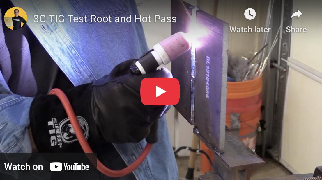

3g-plate-tig-root-hot-tig-finger
Time for another Tig Weld Video. But the only problem is there are no Tig jobs in the shop.
No prob, I just made one up.
I retrieved this hunk of stainless from the scrap bin and thought it would be interesting to do a multi pass tig weld walking the cup ....and Freehand too.
Its a 3 inch thick piece of stainless that was cut from one end of a roller we modified a few months ago. 3" round stainless that is turned down to about 2 inches with a nice radius. Just right for a multi pass weld.
click the tig finger below to learn more
For heavy wall socket welds , multiple passes are required and this piece of scrap very much resembled a heavy socket weld so here we go.
...here are the basic settings:
130 amps, 20 cfh of argon flow using a #7 gas lens setup, 3/32 (2.4mm) 2% thor tungsten, 1/8" (3.2mm) er308L stainless filler metal....and thats about it for tig settings.
As a general rule, I like to use as small a torch as possible.
But sometimes I evaluate a tig welder that comes with a big tig torch that I am not that crazy about and instead of swapping out torches, I just use whatever torch comes with the machine.
Thats when I use a "stubby gas lens kit" from CK worldwide.
The stubby kit makes any big torch seem a bit smaller and for me, that is a good thing.
As I show in the video, I used the "walking the cup" tig welding technique for the first 3 beads and then switched things up.
For the last 3 beads, I switched welders and torches and used a Tig Finger instead of walking the cup.
I used a CK flex loc 150 amp air cooled torch with the 2 series head. This torch is pretty cool.
This Flex loc is a 17 style air cooled torch but can also be used with the 2 series head and small style gas lens. It felt almost like a #9 small air cooled torch.
