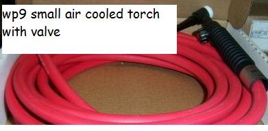

air cooled tig torch wp9v
- look for model numbers with a #9 like wp9, wp9v, wp9p. these are small air cooled torches that accept the small collets and collet bodies and tig cups...and are usually rated for 125 amps.

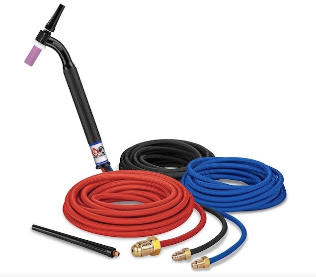

below is a CK trimline 210 ...a 200 amp air cooled tig torch that feels like a 17

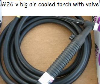

air cooled tig torch 26 with valve
17 tig torches are usually rated for 150 amps and some brands have even changed up the numbering system to read 150 instead of 17.
- look for model numbers 17, 17v, or 26, 26v.
the 26 torches are usually 200 amp and the 17 is usually 150 amp.
These are pretty big torches , like almost as big as a chipping hammer. Try to imagine welding a set of headers and getting in and around the tubes in tight quarters with a chipping hammer. But....If you are going to be welding a lot of aluminum and you are dead set on an air cooled torch, you are going to have to use a 17 or 26 just to be able to handle the heat without it getting smokin hot before you are done with your welds.
