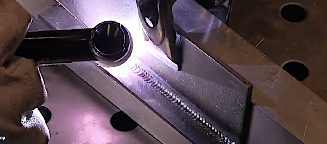

TIG WELDING CARBON STEEL 2F TEE COLD ROLLED 11GA NO PULSE
1. maintain an arc length of equal or less than electrode diameter
2. limit torch angle to around 25 degrees...less is better
3. keep hot tip of rod shielded with argon
METAL TYPE = CARBON STEEL
THICKNESS = 11GA
WELD TYPE = Fillet weld
JOINT TYPE = TEE JOINT
POSITION = 2F HORIZONTAL
AMPERAGE = MACHINE SET TO 131AMPS CONTROLLED WITH PEDAL TO 128 AMPS MAX
FILLER WIRE = 1/16” ER70S6
POLARITY = DCEN
GAS FLOW = 20 CFH argon
CUP SIZE = 8
ADDITIONAL SETTINGS =
PRE FLOW = .5 SEC
POST FLOW = 7 SEC
TIPS: KEEP A TIGHT ARC
Aim for an arc length that is equal or less than the diameter of your tungsten electrode.Torch angle can be forgiving provided your arc length is tight.Keep the hot tip of the filler wire shielded by the argon envelope from the tig cup
