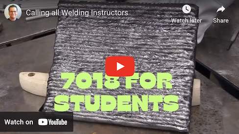

7018 for Instructors and students
A preview of all the different skill drills a student might do in most welding schools.
7018-for-students-thumb for email
