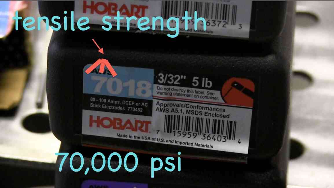

7018 low hydrogen rods
Hydrogen molecules are tiny and are easily absorbed and diffused into the metal being welded.
This can be a big problem on thick steels and/or high strength steels.
Hydrogen gets into the metal and then can create a lot of stress when it combines with other elements.
See this wikipedia article on hydrogen embrittlement
this is the reason for low hydrogen electrodes like  7018.
But 7018 is only low hydrogen if it has been stored properly in a rod oven above 250f.  ...or if it is new out of the box.
The only drawbacks to 7018 are hard restarts, occasional porosity on starts, and the need to store in a rod oven.
For general purpose welding around the shop, where code requirements are not part of the equation, I use 7018 rods all the time that are not stored in an oven.
I just really like the way 7018 rods weld.
  • easy to distinguish the puddle
  • strong ductile weld
  • slag comes off easily and very low spatter
