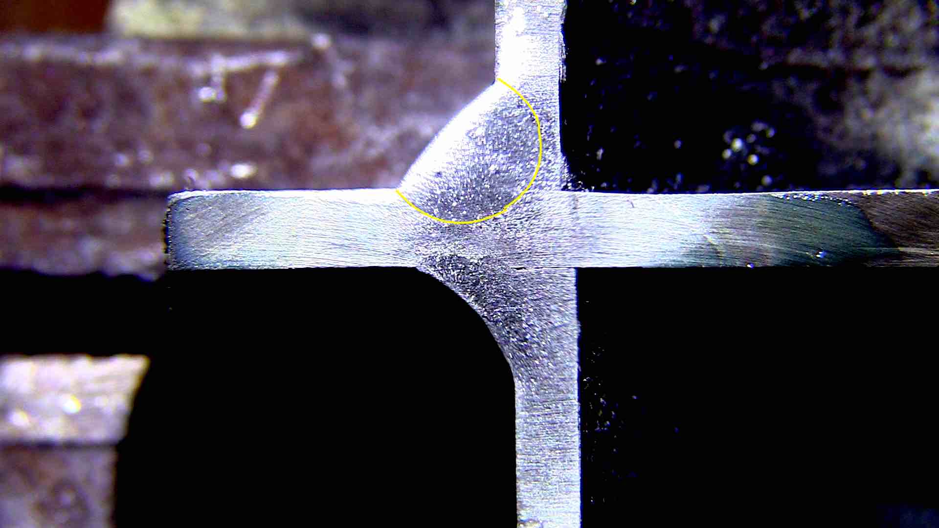

This page is about stick welding a 5F weld test tube to plate.
A 5F tube to plate test is where the plate is vertical and the pipe or tube axis is horizontal.
Usually, there is a macro etch test along with some break tests to check for complete penetration into the root of the joint.
Complete penetration into the root does not mean full penetration all the way thru the back side...it just means into the root of the joint where the 2 members meet.
the image below is a cross section of the 5f tube to plate weld in the video.
the bottom weld is a 4f tig weld done on the back side to save metal.
You can see the video of the 4f tig weld here
5f-7018-macro
