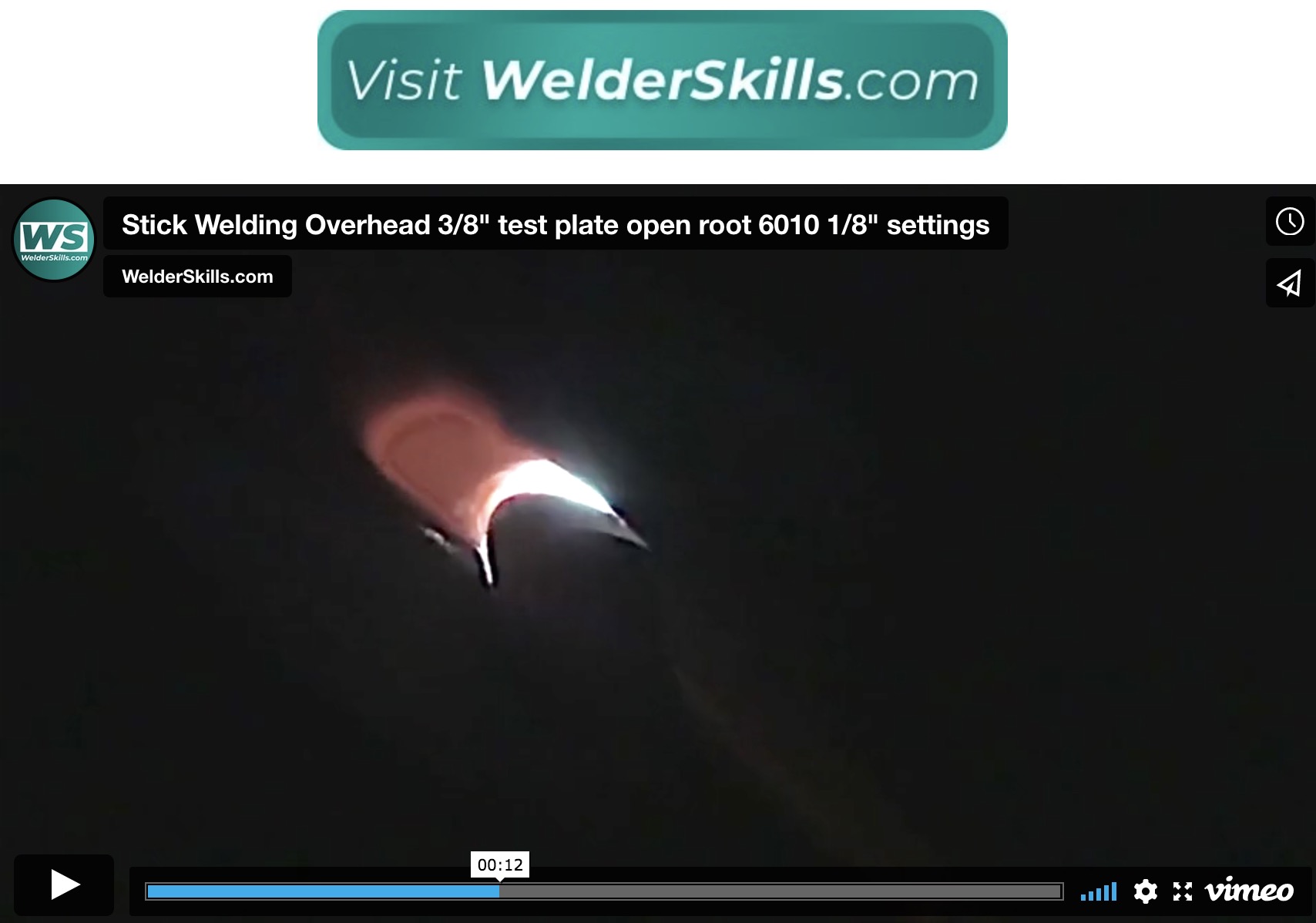

Stick Welding Overhead 3/8" test plate open root 6010 1/8" settings

WELD PROCESS = SMAW, SHIELDED METAL ARC WELDING, STICK WELDING
METAL TYPE = CARBON STEEL
THICKNESS = 3/8"
WELD TYPE = GROOVE WELD  ROOT PASS
JOINT TYPE = BUTT  3/32” GAP 3/32” LAND  30 DEG BEVEL
POSITION = 4G OVERHEAD PLATE
AMPS = 90 AMPS
POLARITY = DCEP
ELECTRODE = 6010 1/8"
ADDITIONAL SETTINGS =
TIPS:   DIFFERENT MANUFACTURERS ELECTRODES REQUIRE SLIGHTLY DIFFERENT AMPERAGE SETTINGS.ANY SUCCESSFUL DEMONSTRATION DISPLAYING AMPERAGE SHOULD GET YOU IN THE BALL PARK.TWEAK AMPS FROM THAT POINT AND ADJUST ARC CONTROL TO FIT THE SITUATION
