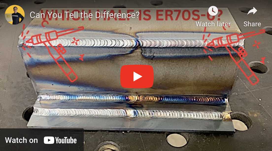

ER70S-6 is a great choice for filler rod for tig welding steel
ER70S-2 is more readily available in welding supply stores and for the most part will work just fine for tig welding steel.
Here is a video tig welding steel with both ER70S-2 AND ER70S-6.
er70s2-s6-corner-lap-tee-thumb
