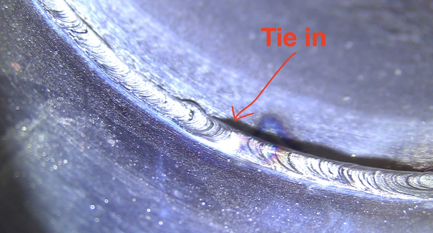

This page is about TIG Welding a Stainless root on 3" pipe.
  • pieces are beveled to 35 degrees
  • gap is 1/8"  (3.2mm) and after tacks were made the gap shrunk.
  • ( if you want exactly an 1/8" gap, you need to account for this on stainless pipe by using a wider gap before tack welding)
  • Tack welds were made at 90 amps
  • I used a small DIY purge box to shield the tack welds
  • After tacks were made, I feathered/tapered the ends of the tacks to ensure a full penetration blend when coming off tacks and when welding into a tack weld....except for one end so that I could show a technique where no feathering is needed.

Technique
For a Stainless Root pass on pipe, I like to use a forward and back technique.
Especially if I am coming off the bottom at 6 oclock.
That is why I used a TIG Finger instead of walking the cup.Its easy to move backwards and forwards with a TIG finger.
For this video, I welded this pipe out in a tripod vise, so I was able to stay from 9 to 12 oclock but on the bottom of the pipe, the forward and back technigue helps to fight gravity and pushes reinforcement.
You dont really need a lot of reinforcement, but some is nice.
Most pipe codes have limits on the ammount of reinforcement but want the root to be at least flush.
