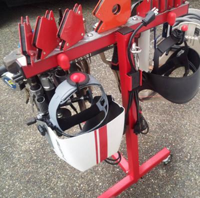

After seeing Jody's video review of SwagOffroad.com's tool organizer, I knew it was made for me.
It's intended to bolt to a bench edge, but I wanted it to be mobile. Also, since we'll be moving to a smaller garage (with house attached), it needed to take minimal floor space.
The vertical support leans forward a bit to move the center of gravity forward to avoid tipping over backwards. It's very stable.

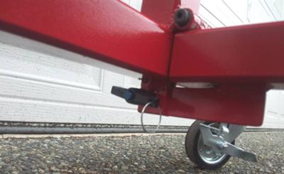

The front leg is hinged to fold up, has a magnet to keep it up and is locked in the down position with a pit pin.
On the back is a 3-plug power cord and a large carabiner.
When I'm not working on a project, the rack stores flat against the wall with the with the wheels locked, the leg folded up and the carabiner clipped to an eyebolt in the wall . Tools are still accessible, but out of the way.
Holds a lot of stuff in a small space.
Total cost $90.
